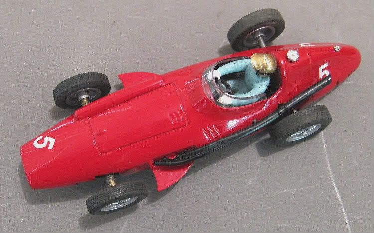

I have to admit this model has been made for some time now, but a scan of the scratchbuild section shows I have not done a review of it?? Mmmmm? Can’t understand why, because it does contain a couple of what were at the time, new innovations, (to me anyway). The first was the front motor with drive shaft to the rear, and the second, which was a part of that, was the ballast fixing. But more of that later.

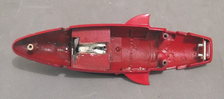

Cockpit space for the drive shaft

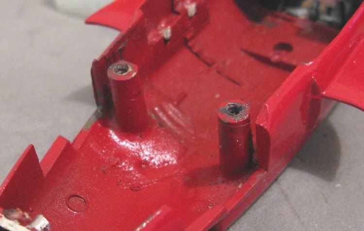

Front mounting posts

Guide and front axle squeezed in
The chassis was duly drawn out and cut and the mounting posts were made and fixed quite early on in the piece. This helped me decide exactly where the motor was to fit. I had also decided to use a full length driver, so the motor was to inevitably be mounted towards the front to give the driver a bit of leg room. The motor was located and provisionally fitted in a cut out in the chassis and the axle mounts were made and fitted. Wheels and tyres were mounted on dummy axles and the guide tube depth and axle positions were determined and fixed in place with a spot of solder. Once the model was looking good on its wheels, the axle mounts and the guide tube were soldered more permanently in place.

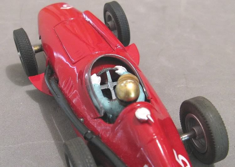

With this the motor was finally soldered in place and the chassis was run ‘sans coche’ for a bit just to settle the whole drive train in. While all this had been going on, there hade been several occasions when the chassis was drying or curing or something was setting. This gave me ample time to paint the driver and the model, clear coat it and apply the decals and one last coat of clear. I had also made a rudimentary cockpit and steering wheel and with the driver glued in place, I ground away at his vitals until the body sat neatly over the chassis, and the driver neatly over the drive shaft, et voila!

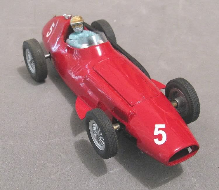

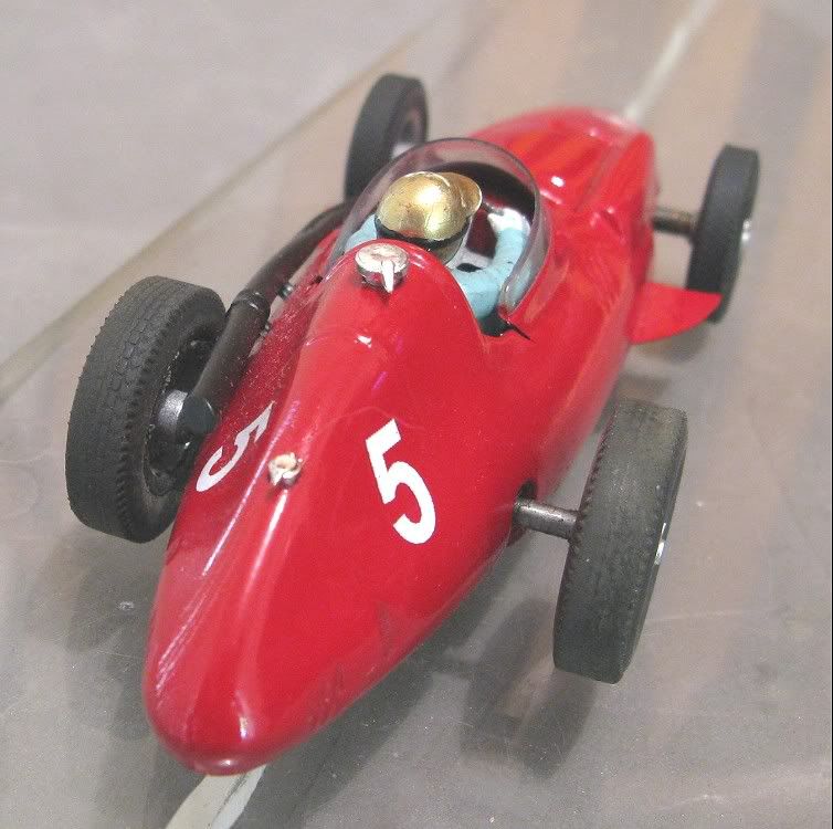

So how does it go? Quite well actually! As a non magnet car it drives really nicely and the SCX motor makes sure it doesn’t rip round the track at 100 kph; and its weight also provides a lot of stability. The wheels and tyres look very authentic too, but I won’t pretend that it is a contender with a Cartrix. Nonetheless, it is quite nippy and I have finished halfway up the results in an average field of about fourteen racers with it.
