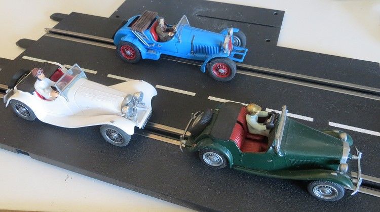

The front end was a bit tricky but eventually fell into place. In this picture the new front wing stays are visible and the Scaley front tyres are also on display. As with many wixwacing creations, the font wheels rotate independently, again to lower the risk and effect of too much front end drag in corners. The front lights look a bit scungey and may get a rework down the track!

So this model has been sitting on the bench for a couple of years now, simply because I hadn’t solved the ‘front end’ problems. But I am now sure I have overcome these and the model should be a goer! Time will tell. In the meantime it can enjoy the company of my other classic cars! All that is left to do is to take it for a fang round my local board track. I’m not expecting it to be a world beater but I’m sure, as with its predecessors, it will provide plenty of entertainment and conversation.
