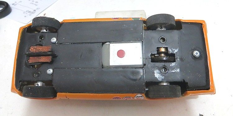

The chassis is the indomitable Wixwacing PCB chassis which has proved itself time and time again. I have also switched from soldering the motors in place. Superglue is proving to be the solution with the hot glue technique running a close second!

The motor is a BWA Ninco NC1 clone (13k @ 12v.) and final drive is in line through a Slot.it 9z / 27z rear end.

The guide is a Slot,it board track guide. I like these because they have a centre screw to hold the guide in. I have also utilized the ‘Wixle’ front end this holds the front wheels in places and allows the font wheels to rotate independently of each other, reducing tyre drag in corners.

Top shot of the rolling chassis. As mentioned before, the motors from the Wixwacing stable are now glued in place.

The two grooves on the edge of the tyres are to reduce grip in corners and minimise the roll over effect. this works well and leaves the rest of the tread area as a slick for straight line performance

So this is a ‘quickbuild’ to get the model track worthy. Interesting to note the fact that I run the model without lube for twenty minutes or so in the beginning. This allows the dry surfaces to bed in and generate the minimum of free play. You can feel the model getting faster lap after lap. Finally some ‘three in one’ or ‘Singer’ oil is applied to great effect. Tamiya fine polish compound is applied to the contrate and again the model is run for several minutes to bed in. The gear finally gets a squirt of ‘Vaseline’ petroleum Jelly to keep things smooth and moving.
