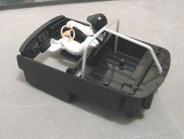

Once the body is off, the basic interior is on display and there isn’t any need to change much here. Good and bad news is that the front wheels are independent of each other. This allows the standard Scaley guide to be fitted, but, because of their loose fit the front of the mode rests firmly on the guide. In magnet racing situations it isn’t a big deal, but in non magnet racing the front wheels won’t contribute as much to corner stability as a solid axle would do.
The underside of the body reveals the drivers tray has been cut into to accommodate the motor. Again not an issue, but I might just paint the visible part of the motor black to help it ‘merge’ into the interior. Scaley have also done a fine and accurate rendition of the dashboard, only on this occasion they have left it black rather than picking out the finer detail in silver.

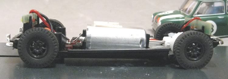

The chassis is very well thought out and all the vital functions are present with no overcrowding. On this model Scaley have decided to attach the lead wires direct to the guide as opposed to using fine single strand wire as they have done in some earlier models, which was a source of unreliability. Light boards are very compact and sturdily mounted and one feature I do like and will note for future reference is the extended motor shaft. This allows the traction magnet to sit comfortably in its rightful position between the motor and the axle, this is a critical factor!
Scaley have also decided on a low gear ration to overcome the small wheel diameter. They have achieved this by reducing the contrate to 20 teeth, this also allows the contrate indent in the chassis to be smaller. Something that becomes an issue with some models on early Scaley and SCX track and also on current Ninco track. They have also canted the motor by four or five degrees to help with track clearances.
There is heaps of magnetraction on this model as illustrated, and even on magnabraid it hangs on for dear life in the tightest of bends. Returning to the independent front wheels, the wheels themselves are as round as can be expected but the tyres are very irregular. They need a good truing before they can be used successfully, and once this has been done, there is considerably less rubber left on the rim!!
