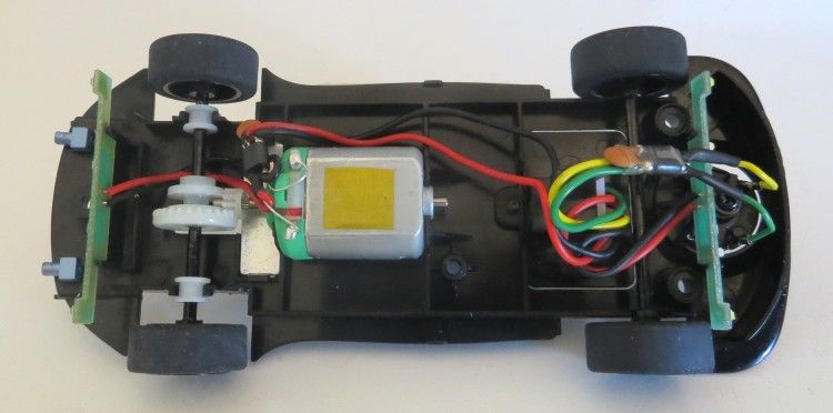

Underneath is reassuring too with no complex pod assemblies and no complex suspension set ups to bamboozle the novice or seasoned slotista alike. In actual fact, simplicity in its most functional form. Again a model which is DPR ready and a glance through the underside grille tells us it comes with the now standard 18,000 rpm green motor as do the regular Scaley cars like the BTCC’s and similar.
Grabbing a screwdriver we soon have the body off and again no surprises or disappointments. The body which is fuss free weighs in at 14.2 grams which greatly lowers its centre of gravity, and gives the traction magnet less work to do; the half driver’s tray is also contributing to low down weight but breaks with Scaley tradition, It is hot welded in place !!!! Not the normal clip in/pop out drivers tray we have been used to since almost Scaley’s inception!
I noticed on my new Scaley VW Passat (reviewed this board) that the rear wing was readily removable; this model looks to share this convenience. Inside there is what looks to be a string of hot glue of sorts on the rear wing pylons inside the rear of the body. This is readily removable and makes the rear wing easily removable if like me you do not subject these parts to the rigours of racing; good news indeed for those who are tiring of making/repairing rear wings after a weekend’s heated racing.
Minor sponsors
Drive train is the norm and has pretty much not changed since Noah built the ark but hey! It works, and if it’s not broken……! The chassis inside is also much as we are now getting from Mr. Scaley and the lightweight chassis is kept rigid by the ribs in the chassis. The guide is a healthy7.0 m.m. deep. One aspect of detail which has taken a step back is the distinct lack of photo etched parts, I was just getting used to this contribution from Mr Scaley but it seems inevitable that the accountants got their way with this feature in a very real effort to keep production costs to a minimum.
Z4's on eBay
Traction magnet is the standard 1.5 m.m. offering and as mentioned earlier it seems to have less work to do anyway. A quick trip to the new wixwacing ‘Magnet Master’ shows that downforce is a healthy 350 grams which only needs to work with a mere 72 grams total model weight. The non magnet racer also has plenty of options for ballast but before contemplating a trip to MDF I would suggest gluing the motor in as the new thinner motor brackets struggle to keep the motor in place! Also, if this were mine I would give it a ‘wixle’ independent front end.
