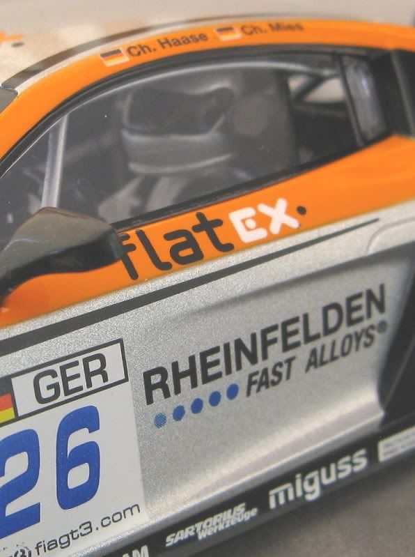

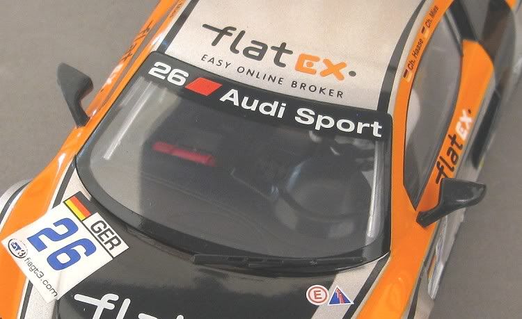

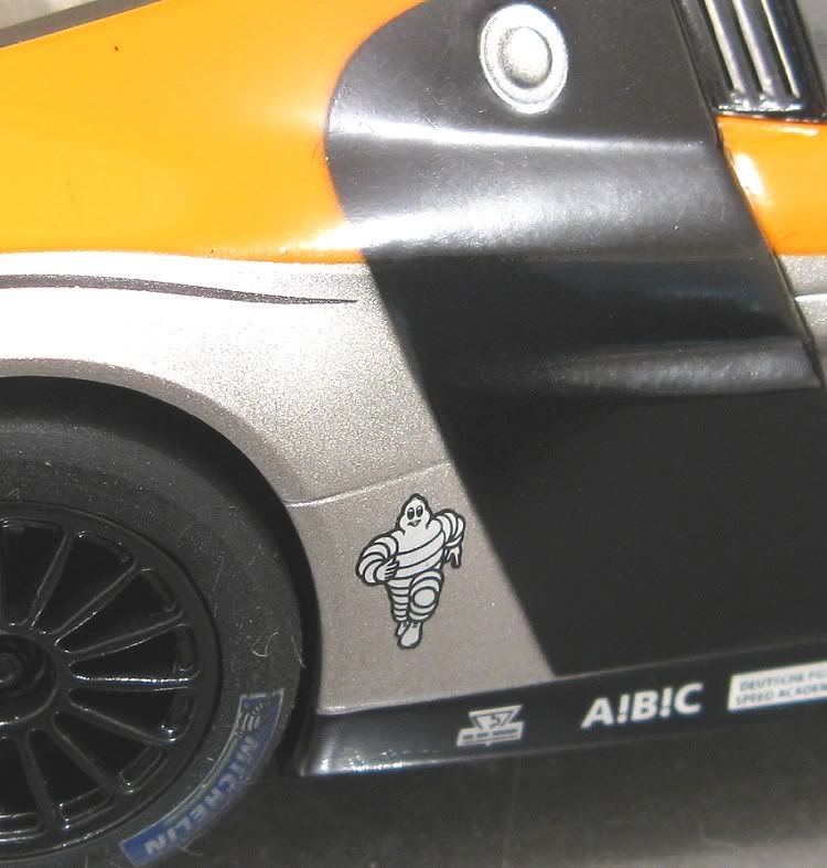

The first thing that impresses you is the livery. Not too fussy but a nice balance of the silver, black and orange of Phoenix Racing. Tampo is almost unfaultable and looking at the on line pictures it seems to be a copy of the 2009 mid season version. And amongst the technology and modernity is the age old image of the Michelin man. Even though the tampo is crisp and accurate, I feel the model could have had a bit more gloss, especially from the silver parts. After all, even race cars shine!

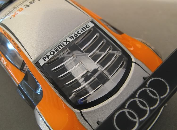

The rear wing is held in place with a soft compound adhesive and it would be quite easy to pull it from the body! This may also be a saving grace in a track incident, and I’m sure the wing and door mirrors will be part of a Scaley spares kit for those unlucky enough to break them. Looking around the interior, Scalextric have opted to glue all their components in place rather than spot heat them. Good idea? Time will tell. But as mentioned elsewhere before, one of the endearing features of Scalextric models which helps to keep their resale value higher than some is the fact that you CAN repair them successfully, regardless of their age!

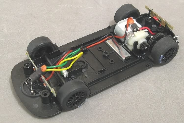

The chassis is tried and tested Scaley fare and there isn’t too much that can go wrong. The guide is sloppier than I would like and an attempt to tighten the screw in the top revealed that it wasn’t doing much in the first place. In fact, the screw turns endlessly with no effect, leaving the guide as sloppy as most SCX cars! Not only that, the two skinny wires from the guide always look a bit suspect to me, having already had one break on the McLaren M23. Luckily, they too are available as a spare part, and Kevin at Scalexworld Adelaide managed to sort some out for me.
Still up the front, the front lighting board is loose in its clamps and it pops out at the first opportunity. It can catch you out when reassembling the body, so it might be prudent to put a drop of 'Blu Tack' in the slots just to hold it down while reassembling. The front axle is assembled in the chassis and on the setup board shows itself to be in the right spot!
Wiring to the motor is tidy and the rear end is pretty much standard Scaley. Wheels are very good as far as concentricity is concerned but the tyres are a little out of shape. The rears are slightly concave across the tread area too, so if you are going to keep the original rubber on, it will need truing. The rear axle has a bit of end float and I would be inclined to shim it out just for peace of mind.
On the track SOOB the model has a very respectable turn of speed and with a couple of adjustment it can be made to fly. Where the body posts sit on the chassis they fit into recesses. For serious competition, I would be inclined to cut the lips off the tops of the mounting post recesses. I might also turn the screw holes out a little larger with a small round file to allow more body movement on plastic tracks. The front tyres would benefit from being ribbed or grooved as this would reduce the amount of drag during sideslip on more grippy surfaces. Lastly, it goes without saying that it would be raced with the two tiny drivers tray screws removed. That should be a good starting point for a successful racer.
