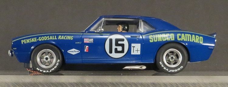

Pioneer have certainly made a popular choice but this model looks to be a replica of the restored car, not the MD original. Not a big deal and the only observation I would make is that the blue of the body colour bleeds through the yellow tampo of the text along the side of the model. It would have been nicer and more striking if this could have been overcome. The splitter under the front valance also appears to be missing.

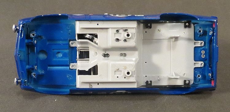

The body is finished well and has a good shine as models should, and the tampo is quite crisp. Only a couple of ‘vulnerables’ too. The driving lights at the front could well be an early statistic in its racing career, along with the side pipe and anodized door mirror. Once again looking underneath, a casual glance would see you being forgiven for thinking it’s a Scaley, right down to the DPR panel! There are positions for six body mounting screws but Pioneer have opted just to use the front and back fixings for this model. An observation would be that if you are a plastic track racer and like to run your body’s loose, you may just need to trim up the edges of the chassis as it is a good fit in the body.

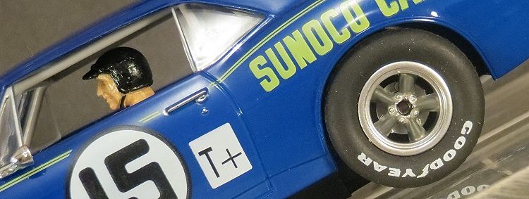

Wheels and tyres are pleasantly concentric and as mentioned before, there is plenty of meat on the tyres; so I assume the rear tyre tread will be the first thing to go on the tyre truer. The ‘Goodyear’ tampo also looks fairly robust and assuming the tyres aren’t immediately swapped for MJK’s or other urethanes, I would say it will be around for some time. I would leave the tread on the fronts as this will help the tyre sideslip in corners and reduce the drag required by this sort of front end set up. The wheels look good too, an excellent representation of the five spoked classic ‘torque thrust’ specials.

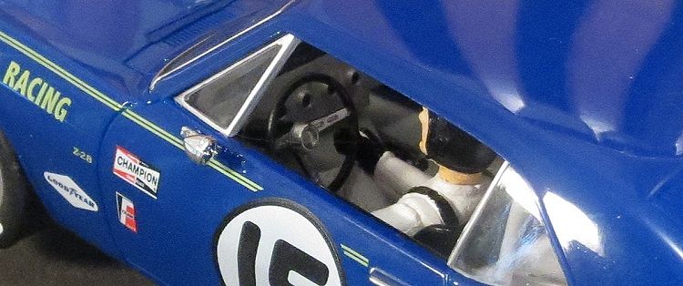

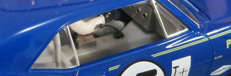

For the collector we get a modest interior and along with all the other major manufacturers, Pioneer have endeavoured to add accurate detail to this little viewed region of the model. One thing that is noticeably above par is the detail Pioneer have gone to with the steering wheel!! But these are all incidentals, the avid racer will want to know what is happening at the business end of the model, but I don’t have much news here I’m afraid. The model is same old same old, and in all honesty, nothing more is needed as this ‘same old’ is doing the job admirably, so why change a successful formula?.........
The chassis is very Scaley at a glance; I suppose the traction magnet and the DPR wiring create this impression! The chassis is very rigid and axles are quite firm. The motor, too, is well fixed and all in all a tight assembly. A choice is given for the traction magnet position but I expect that unless you are racing sweeping six laners the magnet will reside in the position immediately in front of the motor. There is no option to fit the magnet under the rear axle though, which is not a huge loss. Other strange detail mentioned in previous reviews is what looks to be a facility to mount some kind of light board front and rear, but to my knowledge Pioneer have yet to release a model with lights??
The front axle has had some thought applied to it. It runs in dedicated nylon bushes and Pioneer have gone to the lengths of shimming its endfloat to a minimum. The rear axle is also snug in its mounts, which are cross drilled brass bushes. An observation here is that it seems very easy to rotate the rear axle, as if there was not much drag from the motor? When I reassembled the body I noticed the motor revs dropped perceptibly with the body screws tight, there may well be some stress set up in the drive train with the screws tight and work to relieve this may be necessary, to the point of running the model with the body screws backed off half a turn. Scraping the edge of the chassis where it is in hard contact with the body may also help to relieve it too.
Wheels and tyres are very concentric and the inner step on the wheel is quite deep. Gears are made of a grey composite which is quiet in operation and look very durable, and as mentioned before, final reduction is set at set at 3:1 drive ration. Slotcar modeling has come a long way since the sixties and thankfully manufacturers like Pioneer have acknowledged and used all the tried and tested manufacturing features to ensure what we take from the box is what they planned for us, unlike models from the sixties and seventies which were often less than ready to race!
