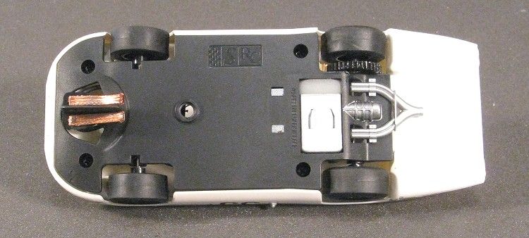

Lastly under the model is the guide. This is one of the plusses for this model as the guide is long.....and deep! You won’t be racing this on classic Scaley track out of the box! And a bonus is that it is spring loaded, no more understeer deslots in banked and cambered corners!
Just holding the model seems to make it creek and on removing the body it made several noises. Not sure where they came from but they were annoying. Next minus came when I checked the four body screws, there were miniature coils of plastic around the screw threads... this meant that the mounting posts had a degree less plastic in them. This did not bode well!
The inside of the model is simplicity itself, and like its cousins, very tidy. Looking at the functional parts of the chassis the first thing noted is that the motor is loose. Being a non magnet racer at heart I tend to spot these things; in non magnet racing this looseness will manifest itself as tramp on take off and judder on acceleration. Not only that, the rear axle pops out of its mounts quite readily. Both of these issues will need to be addressed for either non mag or magnet racing!
Also at the rear and under the chassis SRC have created a couple of holes for the exhaust system to sit in, unfortunately they are directly aligned with the axle mounts and could contribute to flexing at this critical spot. The only saving grace is that the hump of the transmission moulding does contribute to keeping the rear end rigid. SRC have also created some oversized chassis side plates which hold the motor and axle mounts. Here’s hoping they are up to the task!
The traction magnet is good enough for Ninco and Scaley but magnabraid and Carrera will see you at a disadvantage unless this is addressed. The front axle has the traditional up and down movement in it at a time when most manufacturers are going over to a rigid front end. The bonus here is that it may well have the edge once again on tracks with banked and cambered sections. Lastly in the axle department, there is a degree of side to side play in the rear axle which ideally needs to be addressed. I would avoid pulling the wheels off to do this and recommend making some split washers to do the job. These will slide over the removed axle and fit flat once in place.
After I had removed the chassis and discovered the threads on the screws, I lined all four screw holes with some superglue on a small drill bit. On refitting the body after the glue had set there was enough bight in the superglue to get the screws to grip. Putting the chassis back I noticed the chassis does not ‘drop in’ to the body. There is something either out of align or not clearing when trying to assemble it. In the old Fly days it was invariably the lead wires catching under the drivers tray, but this seems different. I had a good look around and I could only surmise that the chassis generally is not the best of fits in the body??
