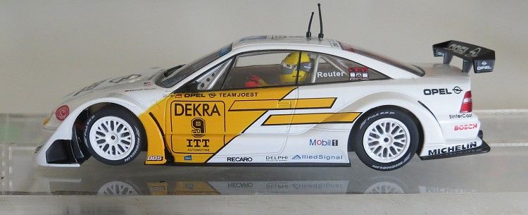

So what have they done right this time, well, in my books the choice of subject material was the first good decision. The livery is striking, and even though I possess the Ninco Calibra, I couldn’t help myself when I saw this one! In the box it looked great and in the flesh it is even better!

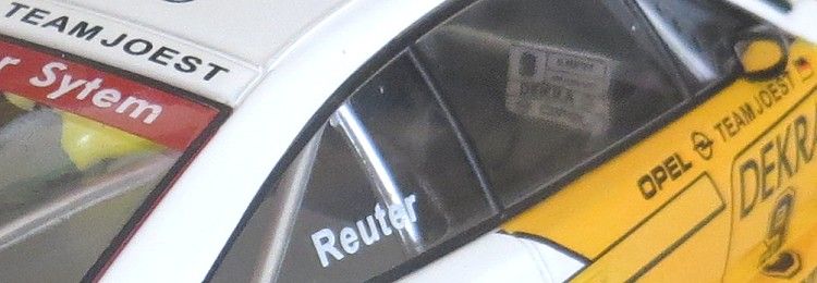

External detail is great and as mentioned regularly, the tampo is almost faultless; looking around the outside doesn’t reveal any worrying developments apart from the susceptibility of the door mirrors and particularly the rear wing to on track incidents. But Slot.it, like a few other makers, does have a good supply of after market spares available; the only thing being that they do not come painted like Scaley spares do! One thing that still evades Slot.it though is a good gloss finish. Trust me when I say real race cars shine! And several of the mainstream slotcar makers seem to be able to pull off a good shine. I suspect that Slot.it are conscious of the weight saving of a dull finish, and the cost saving of one less gloss coat no doubt!
Slot.it have spent a little time on the interior too, there is a good drivers tray with a passable driver, and they have even gone to colour on the dash assembly and a board of some sort on the right side of the cockpit. In some makes this detail would have been left black! It looks too that the drivers tray clips in place like Scaley models. Lastly, on the outside, Slot.it have reproduced the comms and telemetry antenna but one thing I have to mark them down on is the size of the wheels. Being a scale model fan I would have liked to see the wheels a little larger (or the arches smaller!) and the front axle a little wider to match the arches.

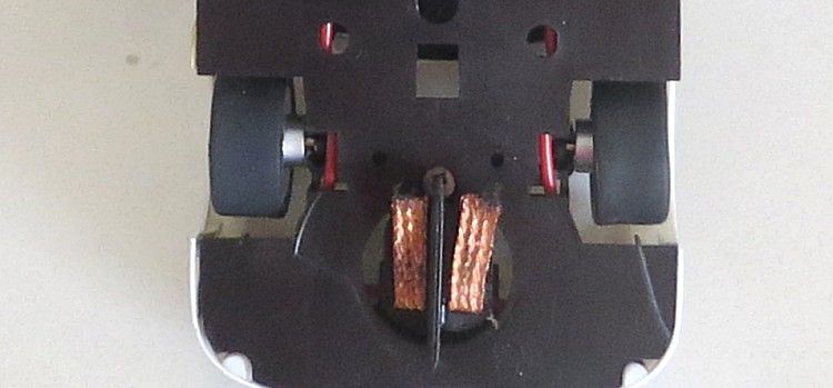

As with other Slot.it models, care needs to be taken when initially removing the body screws. They are tight and if you don’t have a firm grip on the body it can flex quite scarily. Once out they will be ok in the future event of removing the body. Once inside, the finer points of the model are revealed. Nothing new here, all is reliable simplicity which should not bother the racer in the future.
I would sleeve the body mounting posts as a matter of course if the model is to be raced, they are a bit skinny and sometime in the future I can visualise the sides snapping off them during a hectic pit stop. The front axle too has a bit more up and down movement than I woud normally like. OK for tracks with fast sweepers, but on short course technical tracks the model will need all the lateral support it can get as the model changes tack several times at speed.
Also, this is the first time I have come across the current front axle mount set up! Gone are the grub screws for setting axle heights and in come a couple of ‘devices’ for want of a better word. These floating mounts slide into the body and the axle holds them in place once it is slid in. The holes in these sliding mounts are off set so be careful which way round you install them. One way round gives a low front stance and the other way round lifts the front of the mode more than a millimetre or so, and raises the guide in the slot too. You can’t race without them as the front axle will slop about all over the place. My best advice is that unless you need to touch them….don’t!
Penultimately, an observation would be that the body creeks when the model is handled. To me this indicates the thinness of the body, and along with the vents and ducts in the body moulding there is going to be more than one model end race day with an uninvited crack or split in the body. But maybe I am being too apprehensive…..time will tell. The good thing is though, that unlike Scaley and the like, a body is available as a spare part, albeit unpainted!
A final observation would be that the drive train is as per other ‘in line’ Slot.it’s. The front wheel rims are plastic and very concentric as well as being a tight fit. The guide feels notchy in operation and it appears that the lead wires need repositioning to overcome this. Rear wheel rims are alloy with short hubs. And the rear axle bushes are the self centring spherical type. As with the Alfa, this pod chassis carries the Slot.it V12/4 MX15 rated at 21,000 rpm @ 12v. The standard Slot.it magnet is placed between the motor and the rear axle, and the motor is tight in its mounts, and the 9:28 final drive reduction is smooth in operation
