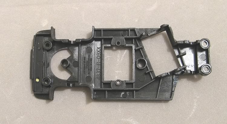

Underneath we can inspect the business end of the model. An angle winder which to me looks a little one sided. I couldn’t get an exact measurement on my digital scales but the side to side weight difference appears to be in the region of six to seven grams. There is the usual adjustable Monogram magnet in the forward position and that humungously deep guide which will exclude it from SCX and Scaley tracks, out of the box! My first impressions, having already played with and raced the Carrera M20, is that it looks so small! So, onto the internet in search of its specs for a comparo, and this is what I found:
Four very nice screws hold the body on and these mustn’t be confused with the two which hold the magnet in. They have a smaller gauge thread and will pull through if put in the body mounts. The easiest way to differentiate between them is that the magnet screws have smaller heads on them. Inside is a very rugged chassis with plenty of reinforcing moulded in; especially around and behind the motor where other makes that spring to mind are sadly lacking. But there is a vulnerable spot to the chassis. That is the guide mounting tube. This part of the chassis is decidedly thin and not up to the job, but there is room to reinforce it and that’s what I will be doing.

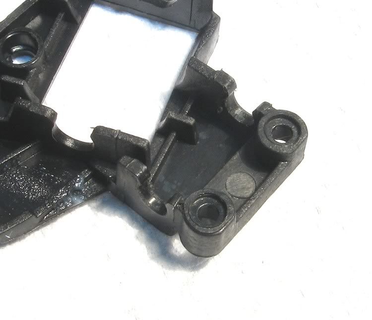

This was caused by moulding flash on the nylon bearings and on the bearers in the chassis. I scraped the flash marks off the axle bearings and trimmed either side of the bearers. The axle was refitted and sat squarely in the chassis. There was still a slight discrepancy but repeating the process with the front axle bearings cured the problem.

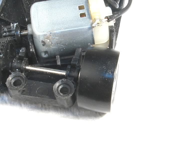

Next was the motor. This was clipped into place and the first problem was a binding gear mesh. The rear axle was a bit stiff. There was no backlash at all between the pinion and spur and the spur gear obviously had a high spot as it would bind in the same place each revolution. I ran the drive at low speed after applying a little Tamiya fine polish to the gears and the motor noticeably increased in speed with time. After a couple of minutes I washed the polish off with water and applied a small amount Vaseline. The gear was still binding a little and the final fix was to slide the pinion down the motor shaft just enough to generate a little slack. The result was an appreciable increase in motor speed. Problem one solved.
Next up was to retry the body. Once again the chassis was unable to slot straight into the body, so something to do with the motor was at fault. After looking round I decided the RI components on the front of the motor were contributing to the problem. The components and lead wires were completely removed and the problem was reduced. Next up I removed the solder from the motor terminals and this allowed the chassis and motor to slot into the body neatly. Mmmmmmmm? I decided to fit some new lead wires as the existing ones were now too short with the components removed.
Both eyelets were removed from the old leads simply by applying the soldering iron and pulling the wires out of the flattened eyelets. Both ends of a length of lead wire were stripped back four m.m. or so and tinned. With the iron on the eyelet, the new lead wire was slipped into the eyelet and then left to cool. The wires were refitted to the guide and the wire cut to length, stripped and tinned. I placed the tinned ends of the wire under the motor tags and soldered them in place. The solder on the top of the terminal tags was filed off and the finished job offered into the body. The front motor terminal had been fouling the body but now was clearing it by the smallest of margins. Another job jobbed!.

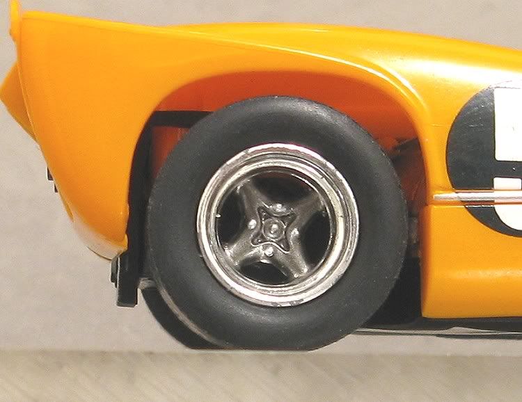

I managed to true the eccentric rear hub sufficiently to keep runout to a minimum but one of the front wheels was less than satisfactory and some careful sanding will be required to get it back into shape. Lastly a minor alteration was to apply a 40 watt soldering iron tip to just under the wing mirrors while keeping some upward tension on them. After twenty seconds or so the mirrors pulled free complete. These will be kept in the display case until the model is retired and then they will be restored to the model. And with the model in blueprint condition, all that is needed is to give it a good magnet track work out! That will be a few weeks away yet.
