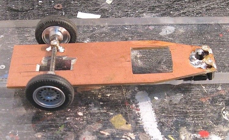

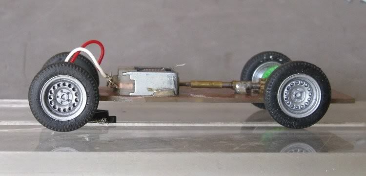

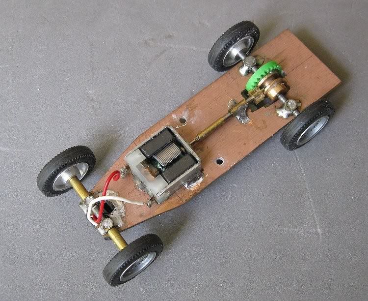

It was accepted that they would have one of the wixwacing patent PCB chassis and power was to be from one of the little HO cube motors we had bought. Drive to the rear axle was going to be by propshaft and as much of the interior detail would be retained as possible. The chassis was cut to fit inside the underbody of the kit and then the axle layout was established. Once settled on, I could then determine where the motor was going to fit.
Another tricky bit was the propshaft. The motor has a 1.5 m.m. output shaft and the pinion shaft is 2.0 m.m.?? A solution was at hand though. Terry called in a favour of one of his local modelling friends who has a modellers lathe and had some joining pieces made up. A short piece of brass tube counter bored 1.5 at one end and 2.0 at the other! This was a press fit on the motor and a drop of solder fitted it to the tail shaft. The tail shaft also had a sleeve over it which would act as a rear mount when the motor assembly was fitted in place.

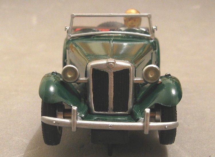

Once the motor and axles were fitted in place, the guide was squeezed between the motor and the front axle. Not being a racer, I didn’t want it to be proud of, or noticeable from the front. The body was assembled and prepared for painting in my usual way. The parts to be silvered were left off and were given their own treatment of ‘Bright Chrome’ enamel from the auto store. Once well dried, the silver had a couple of coats of clear acrylic.
The windscreen was painted on its front facing surfaces and once dried was placed over a piece of clear sheet that had a strip of masking tape on it. The screen frame was drawn round and the screen profile was cut and sanded to a better fit. A film of clear epoxy was brushed onto the back of the frame and the frame was placed on top of the clear screen. Once I was sure it was in the right position I laid some square alloy tubing on top of it purely to hold it in place while the epoxy was curing.

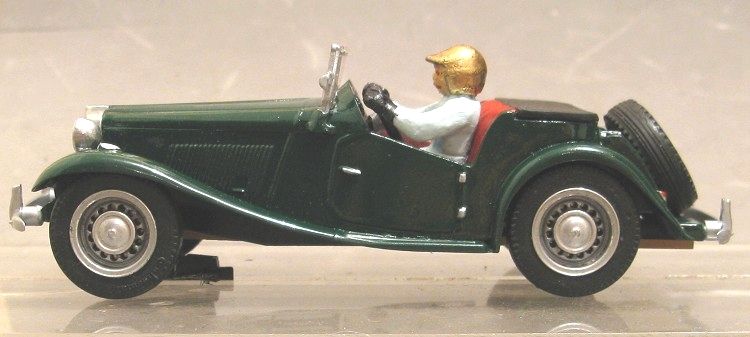

So what was the tyre solution? Not easy! Looking through my extensive spares boxes I came across some Airfix tyres. These were for the front of their early Auto union and Mercedes models and fitted the rims a treat. The tyres even have the ‘Continental’ logo quite clearly on the sides. The model had a few practice laps at the Red teams home track before it was painted, just to iron out any faults. As it turned out, there was very little to be done, and a couple of minor axle adjustments saw the model running beautifully. At the time of writing I do have some urethane tyres being moulded, in the pipeline, but until such time as they turn up the model will run very nicely on the Airfix rubber.

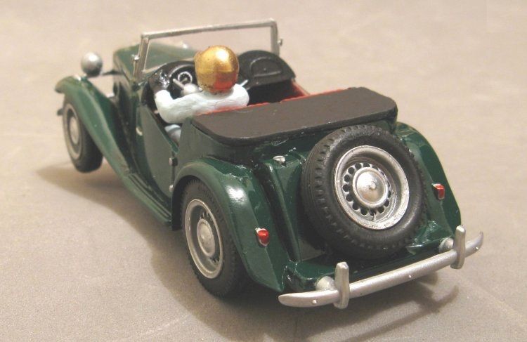

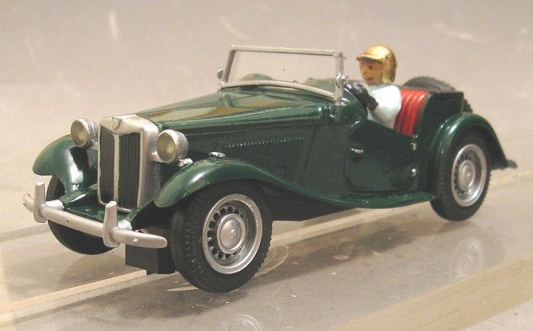

So with the chassis working well it was time to finish the body. What was it to be? Green, Blue, Cream, Red? So many choices, but in the end I decided to livery it in BRG and after some picture searching on the net I settled on a basic road going livery. The black bits on the radiator were painted before fitting and other small parts like lights, door handles etc were painted on and clear coated. The hardest bit was fitting the driver. He already had a 1/16 pin sticking out of his bottom which lined up with a corresponding hole in the drivers seat. The necessity for this was because the steering wheel had to be slid in at the same time as the driver, and the driver needed to be fixed before the glue dried to stop the steering wheel sliding back out of position!! Anyway, it all worked and the driver and the wheel are now fixed in place.
Last items to be fitted were the front and rear bumpers and the screen. This was all pretty straight forward though and the only hiccup was that the bottom of the screen frame was a different contour than the bonnet. No matter, it’s on now and you don’t notice it if you are not looking for it! The screen was stuck with clear epoxy, this was to impart a degree of strength to the screen incase there was an unpredictable deslot. Hopefully the screen will be tough enough to remain in place.
Once again I reckon I have finished up with a great little model and I’m sure there will be several local racers who will lust after it once they see it! Once it has done the rounds I’m sure it will be happy in the cabinet, and happy to be taken out and run on special occasions!!

Local guy Jordan (Kenneth) kindly made me a pair of urethane tyres for the rear, moulded from the originals. The model is an absolute pleasure to drive..... not at breakneck speed, but with the voltage turned down to eight or nine volts. It is generally not understood that nearly all the little HO motors are rated at 28,000 rpm, from Ninco Karts to Scaley trucks and even the dreaded Scaley Fiestas!!! So some sort of speed attenuation is required. The result....I could drive it for hours on its own!. It looks especially fabulous on a landscaped track like the Red Team's and you can almost sense the wind in your hair!!??. Maybe I'll make a long silk scarf for the driver??? Mmmmmmm? Now where's that Matchbox '48 Jaguar 'SS' ? ? ? ?
