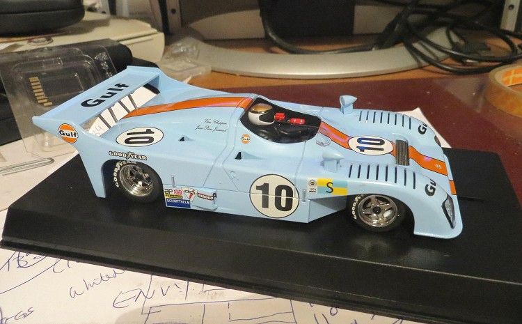

First and foremostly you would have to have been dead a long time if you didn’t go for the Gulf Livery; probably the singularly most popular livery to date and one that usually puts another $50.00 on a model’s price on eBay!! The blue and orange has been around for many years now and never fails to attract.
Pulling it from the box there is also a multi lingual instruction sheet. This tells you how to adjust the several screws and bits around the model for optimum performance. The model is not that complex but if you are new to this type of model and haven’t ‘tinkered’ before, then I suggest you take a few minutes to read the notes before proceeding to adjust anything.

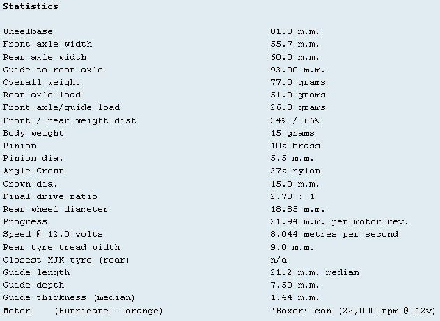

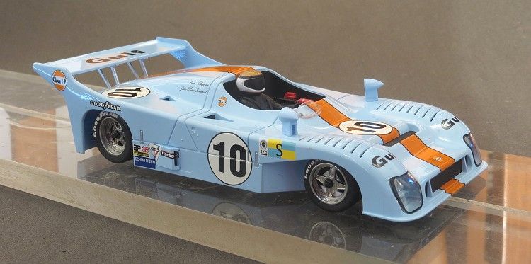

Once again, and as with the Metro 6R4, this is a very thin bodied model! And this time the body weighs 15 grams! But it is a very attractive 15 grams. Tampo is good but there isn’t that much of it to worry about. At the time of the original car advertising was still modest on most racing cars and apart from adds for brakes, shocks and tyres, there’s little else on the model to adorn the flowing lines.

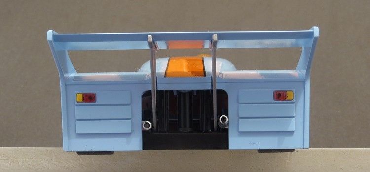

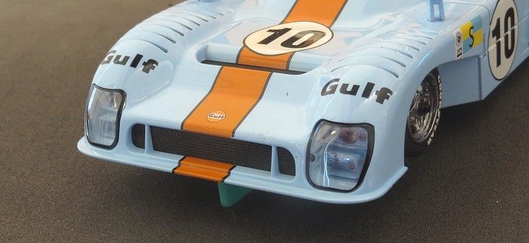

Front light detail is fair, but, hidden behind the clear covers they are fairly insignificant. Back end detail is very basic too and on the real thing I would be sure there would have been a bit more going on detail wise. One of the few prominent features at this end (the exhausts) look to have been glued on out of align which was a bit sad, but no matter.

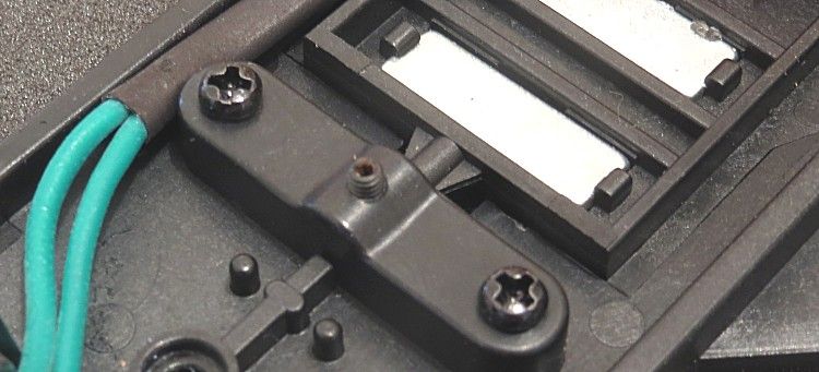

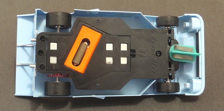

One initially alarming site were the three magnets in the chassis. Expecting the model to get stuck hard and fast on a piece of plastic track I was surprised when it didn’t offer that much more magnetic adhesion than most models. The magnets are not ‘full strength’ type magnets and they offer what must be a calculated downforce for this model.

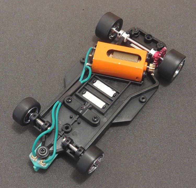

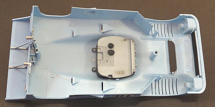

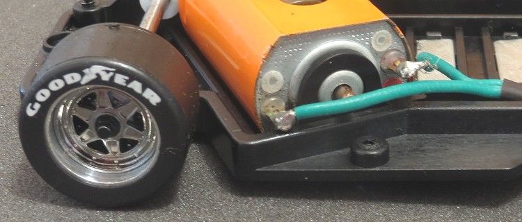

Taking the body off, the layout inside is that of another minimalist model, designed for racing first and showing second. The motor is mounted in a separate pod which seems to be the current trend now, and the chassis does not seal the underside of the model but just sits there with the naked edges revealed. Again. Not what I was expecting but who is to say that there is anything wrong with that?
The chassis is fitted to the body with two screws, and the pod is secured to the chassis by two screws at the rear and what looks to be an adjustable screw and bracket at the front. Turning this screw raises or lowers the front of the pods slightly, and influences the magnetic downforce to the front of the model. At 7.5 m.m. the guide has enough depth for most tracks and will in fact be too deep for some home tracks, and there is no spare guide supplied for this eventuality!

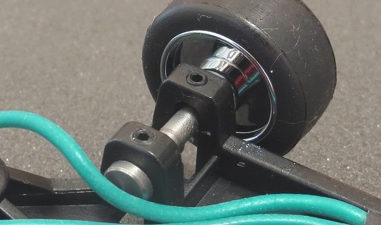

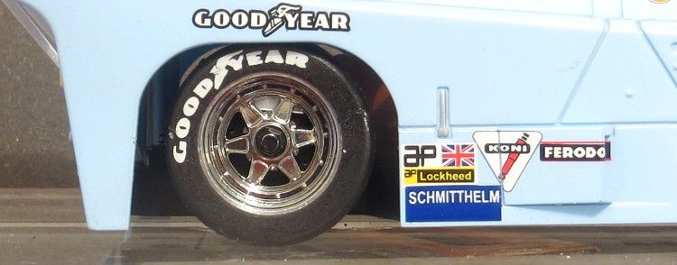

The front axles are stubs, something I like to see. There are issues enough on a lot of models with front wheel drag and the only other option to overcome this is to set the axle up to clear the track. On this model you can play with the front axle height and still have a firm front end, much better than some other independent front ends I have come across. Front wheels are plastic, unlike the rears which are machined aluminium with anodised inserts.

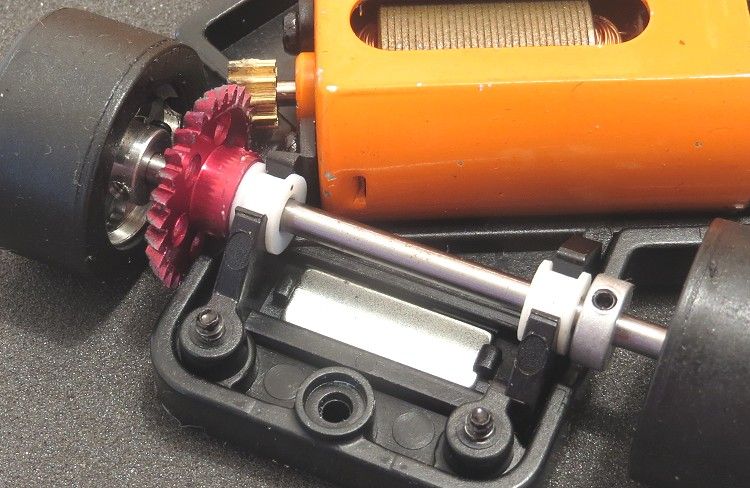

The motor is clipped tentatively in the chassis but the saving grace are the two screws holding it in at the gear end. There is a brass pinion and an alloy angle winder gear very similar to those seen in models that run Slot.It chassis'. The axle bushes are firm too and there is an alloy collar on the rear axle for centering the axle in the chassis. Gear mesh is pre set by the left hand axle bush. If you want to run a tighter fit you will need to add a fine shim or two between the gear and the axle bush.
