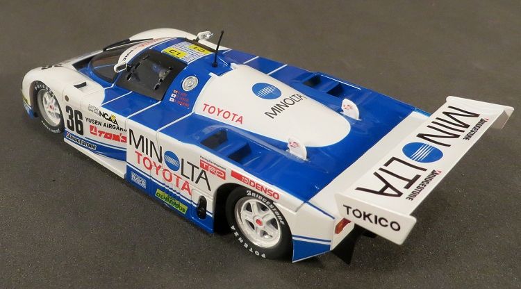

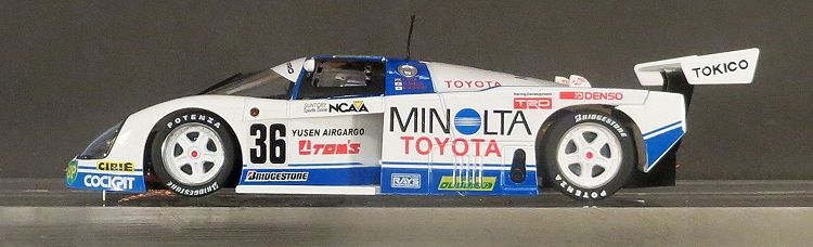

Yet another nice model from Slot.it, and again, a model which will need a little care on the track if you want it to last more than a week-end! That’s a less than veiled hint at its very flimsy body. At eleven grams you won’t want too many racing incidents or you could find some very lightweight parts separating company and the model going home in a bag! No, matter, let’s pretend it is indestructible and move on.
As always and starting with the outside, Slot.it have managed to pull off a nice finish reminiscent of some of the early fly models. There are one or two details the model lacks but these fall into the delicate category and are better left off. Side on it has a good stance and most should be happy with its on-track appearance. The Minolta livery is an eye catcher and Slot.it have modeled the wheel inserts in true likeness. The rear view mirrors are in the roll over zone and will be vulnerable along with the delicate rear wing and headlamp covers of which mine always seem to crack early on in their life.
Interior detail is there as always even though it is barely visible, and the tampo is fairly crisp. The model has an in-line configuration and this has allowed the fitting of a standard traction magnet in the best spot, between motor and axle. The plastic front wheels are concentric and the tyres fit well with little truing necessary. The rear wheels are the usual alloy long hub type. For serious racing I would be inclined to upgrade the rear wheels and tyres the next width up (10.0 m.m.).
Inside is pretty much standard too with the motor being the RTR standard 21,500 motor driving the rear axle through a 3.11:1 brass and nylon reduction giving the model a theoretical top speed of just over seven metres per second. For the non magnet racer you will be pleased to know that the motor is tight in the chassis as Slot.its usually are, and on reassembly the body and chassis fit together quite snugly and hassle free placing the body back on the chassis.
I had the opportunity to run the model on the four lane ‘Four Seasons’ Carrera slotcar track at Eagleby south of Brisbane , and admittedly it was on a fresh track before practice for the days racing had begun. As expected the model was very predictable at all speeds and responded well to the professor motor controller I was using. If anything it had a slight tendency to step out on the low downforce track, but no where near as much as some models out of the box.
A few more laps saw the dust off the track and the standard tyres working well. I would recommend though that for low downforce tracks like Carrera and Magnabraid that the magnet be changed for the Slot.it upgrade competition magnet. Those who race at home or at their local track where Scaley or Ninco tracks are in use, I think you will find the model well balanced straight from the box.
So with no bad habits Slot.it have done it again and given us a model which looks good and goes well out of the box. It would be nice if it went well straight out of the wallet too, but at a time when all makes seem to be increasing in price, that becomes another story.
