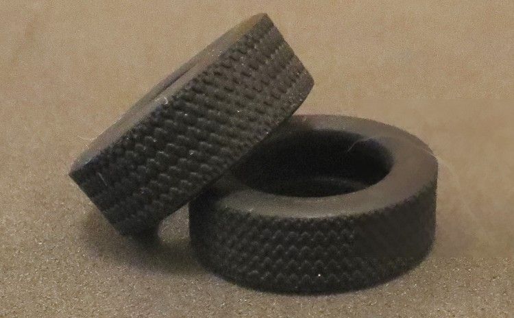

Looking at the business end of the model I note the tyres come with full tread detail. Tyre compound feels to be a rubber of sorts, but we all know by now what happens to Carrera tyres if you use tyre treatment on them don’t we kiddies! The wheels are also two pieces which Carrera have done before, in some cases it is only the tyre sitting on the rim which holds the halves together! I also notice that the rear tyres are 0.5 mil wider than the fronts MMmmmmmm?!
Topping this, and with Verniers in hand, I can definitely confirm that the wheel major step (centre ridge) is at least two centimetres proud of the tyre step. At this stage I am not aware if anyone is making urethanes, but I am sure the day can’t be far away.

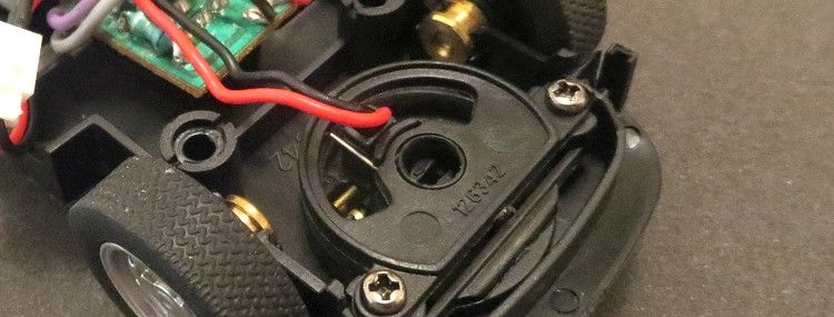

Looking underneath the body I see that this is another model which has been set up for lights. There are definitely light mounting brackets on the chassis, and the dead give away is the black paint, underbody, front and rear used to stop light bleed through the model! One of the most critical parts of a slotcar is the guide. Without a good guide system you are just a marshal’s nightmare. Carrera have once again opted for a spring return, self centering guide. As I have mentioned before, It has its advantages but my concerns lay in the corners where the spring guide is working against the wishes of the model.
The model also comes with one spare standard guide, and one smaller guide which helps the model perform on Scaley, SCX and Ninco track. Carrera doesn’t have ‘inner’ curves, being a 1:24 system, therefore the model doesn’t need the narrower and shorter guides for the tighter bends. Going back to the guide return spring, this is accessed by the removal of a couple of screws at the front of the model thereby which the spring can be doctored if you require! The braids themselves are of the plug in quick change variety and can be changed in a jiffy. Spare braids and the smaller guide blade are accessed in the rear of the crystal display case!

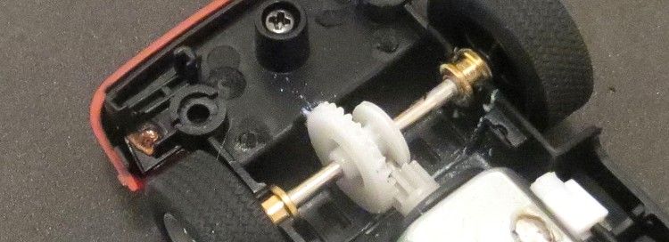

As we approach the end of the review there are only a couple of items to mention. Old hat to the seasoned Carrera racer are the two traction magnets securely clamped into the bottom of the chassis. One between the contrate and the motor; the other, between the motor and the polarity switch; they are removable though, without damaging anything, with the aid of a screwdriver. The two magnets are for use on low magnetically sensitive track like Carrera, and you may well find that there is too much magnetism for the regular steel conductor rails like Ninco, Scalextric and SCX!
Also a perennial fixture is the polarity reversing switch. The motor is a can end drive which will give you lots of options if you race a variety of motor classes, and more often seen in Carrera models these days is the independent front end. Front wheels which revolve independently of each other, reducing front end drag in turns.
Not being a magnet car racer I cannot give you the benefit of insight to that type of racing, what I can tell you is that the model set up is in line with Carrera’s current mode of construction, it therefore has to follow that the model should run well out of the box all bar a bit of blueprinting both inside and out. Closer to home on non magnetic board tracks the model is a little skittish out of the box but this is attributable to the tread on the medium soft tyres.
A little light sanding saw the cornering performance improve quite dramatically, but, as mentioned before, over time, these tyres do funny things if treated with chemicals of any kinds. Nearly all Carrera owners must have experienced their rear (and sometimes front) tyres withered like dried prunes when next removed from the race box! And, as mentioned before, urethanes at this stage may not be available because of the wheel profile. No doubt someone will remedy that in the near future.

As for MJK tyres on Carrera classic racers, I could get the 21 x 7mm (Ninco classic size 4214 I think) ones to fit on the Carrera AC Cobra. Its wheel had a large centre step that meant the MJKs sat up off the rim. To remedy, I mounted the tyres inside out on another wheel to spin like a lathe, and used a file to cut the recess deeper. The tyres then fit well, and the AC Cobra is now my fastest skinny tyred car.
So assuming the Ferrari P2 has similar wheel dimensions to the Cobra, the above trick should work.
