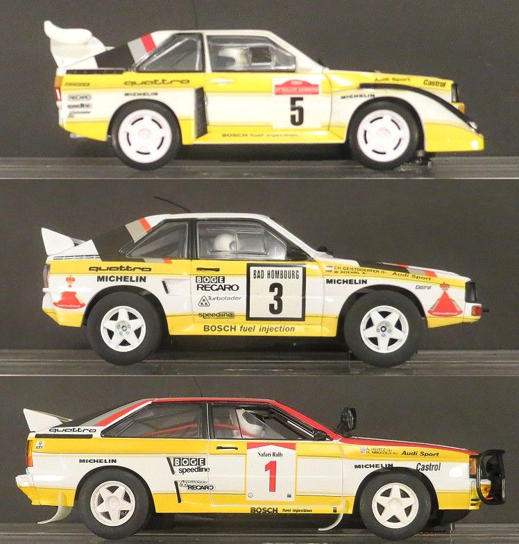

Big shoes to fill indeed and not to be undertaken lightly. Revell tried it with the early S1 and although detail and finish were good, the final product fell far short of the image with the model very unstable on most surfaces. I suspect Revell wanted to reproduce the tail-out stance the S1 could achieve quite freely in any corner, only Revell’s model doesn’t give the impression it spits fire and brimstone on most surfaces! The traction magnet is vestigial to say the least and the model readily topples over in all but the most sweeping of bends......gladly, Mr Scaley has done better than this .....but first things first!

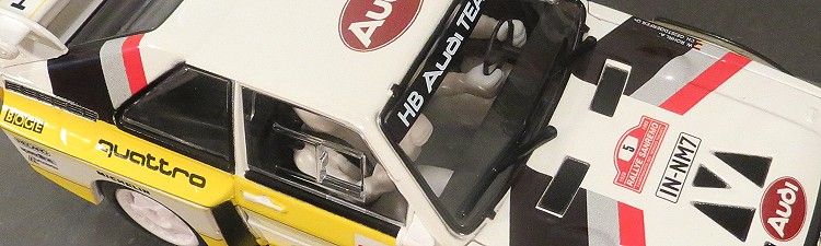

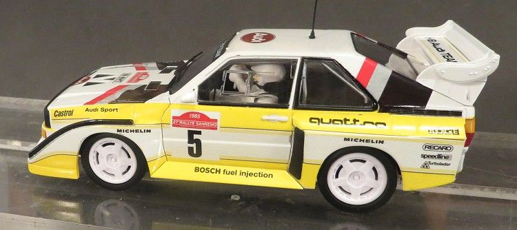

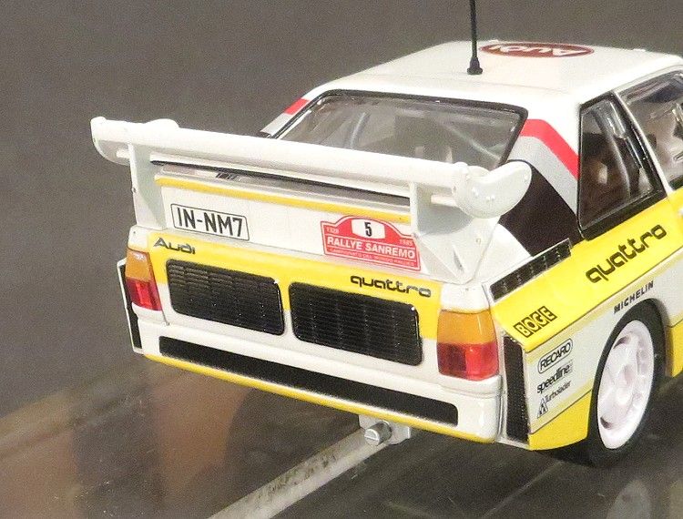

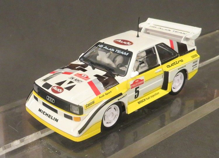

The first requirement of a good slotcar is to look good, and Mr Scaley has captured this well. Paintwork is mostly good but on my model there are some very average tampo overlaps around the guards (wings/fenders) Colour is good and Scaley have captured most of the feel of the sponsorship except, probably due to tobacco advertising laws, Scaley have decided to leave the German American HB International cigarette company advertising off the model, with the exception of the HB on the screen sun visor. This is a point to Revell as they have included this in full. Looking round the model Scalextric have managed to accommodate everything else.
As with the real thing the model’s striking feature is the large air dam on the front of the model and the ‘sponsons’ on the sides covering the huge increase in track. the rear wing looks like it is here to stay so I defy anyone to loose it under normal racing conditions. The overall impression is of a utilitarian body as apposed to modern rally cars with their gratuitous body styling. Inside the cabin is a nice interior with a full crew and accessories, and a set of plain wheels and useable soft tyres complete its outward appearance.

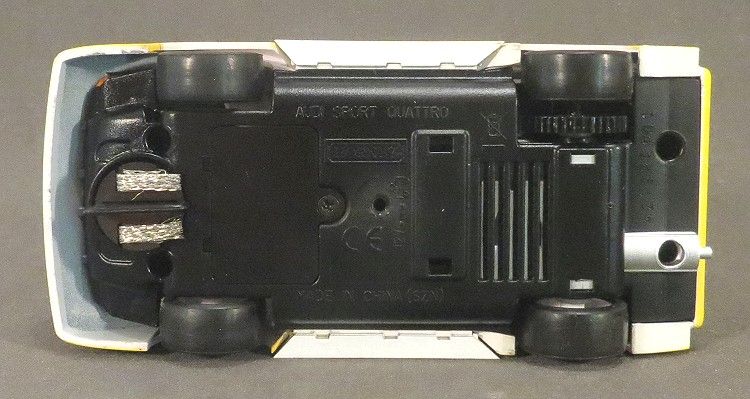

Looking underneath, the axles are fairly snug in their bushes with endfloat a minimum, and the wheels are pleasantly concentric but the tyre tread areas are considerably convex; this is due to the differences in the large and small steps of the plastic rim. On the rear the tyres are undermoulded and this causes the large step to push the centre of the tyre tread out into a hump; so there is a bit of sanding to be done here.
The odd thing is that the front wheels are smaller than the rears by about a half mil?? MMmmmmmm? but they still suffer the same fault, but as fronts this is not so important. As well as some realistic tyre tread patterns it would also have been nice to see some tampo’d tyre names on the sidewalls, but Scaley have opted to ignore these features.
Also underneath it is interesting to note the axle-position magnet slot behind the motor has been used for the traction magnet? I first came across this with the XB Falcon when there was an uproar about the effects of the offset magnet (which I believe were much overstated). I have since discovered that the rear position is for the thinner standard magnet. If you try and fit this in the forward magnet position it is loose and needs to be glued in, but the thicker replacement magnets currently available clip very nicely into this forward position. All else is Scaley fare and the model is also DPR.

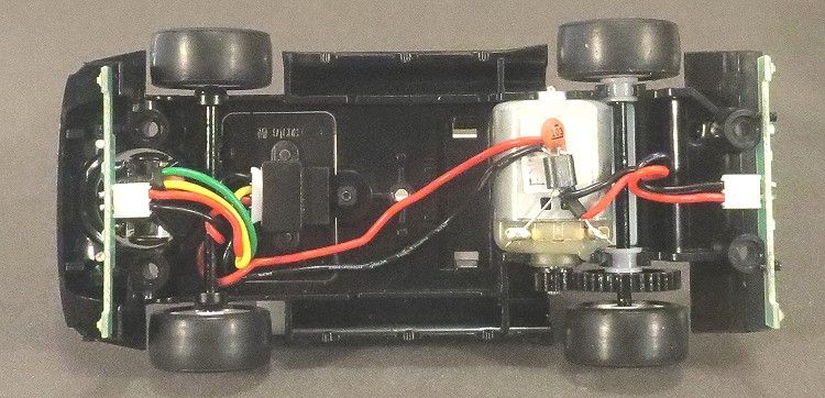

Once again inside the model everything is very neat and tidy and there are no nasty shocks. The rear light board is tight in its mounts but there is an issue at the front; the ferrite choke on the lead wires gets stuck under the front light board and holds it out of its slots; in turn this interferes with the guide movement and also prevents the body fitting snugly on the chassis and tightening down could see something break. Some careful manipulating of this device will see it tuck down the side of the guide and finally clear the light board. The two single strand wires which go onto the guide are actually the legs of the capacitor, and I have had these break on well used models. If you are going to give this or any of the Scaley models with this system a lot of work, I advise you to desolder everything, discard the capacitor and the choke, and resecure the lead wires directly to the two ‘shoes’ which slot in the guide assembly.
There are a couple of other things to watch for before putting in some track time. When replacing the body on the chassis there is a tendency on this model for the red wire to get trapped under the body mounts, so just make sure it is to one side out of the way. Scaley have also departed from tradition in that they have glued the drivers tray in instead of relying solely on clips. Any attempt to remove it by unclipping it could see the clips break.
