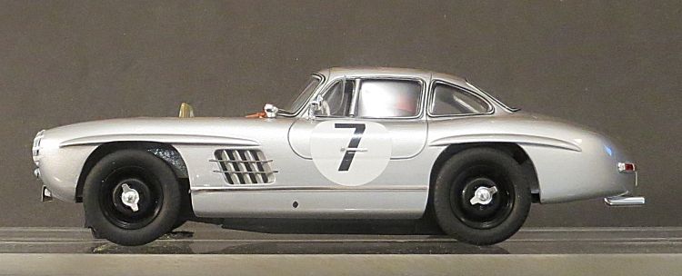

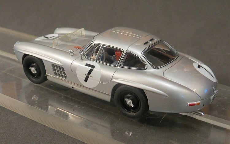

The models are resin cast and very accurate in detail. One of the best points is the blemish free paint job and the shiny smooth clear coat; but the plusses don’t start and finish there. The door and bonnet gaps are faultless and the representation of the rubber window seals and anodized expander trims are amazing. All exterior parts are clear or anodized and fine trim like door mirrors, handles, trims and lights are all executed to true scale proportions. The only minus is that one of the side trims, which are made from a fine foil, is peeling from the body and care needs to be taken when handling it.
Tampo/decals are minimal but again faultless; and I like the way they have posed the drivers quarter glass, this is a feature of the amazingly well fitting vacuum formed glass parts. Interior detail is good and I am always surprised by the level of detail some makers go to considering these areas are seldom seen and soon forgotten. The driver is focused on his job and Top Slot have given him a smart interior to be focused in!
The model comes in a more than adequate display case which must be an expense in itself. A clamshell case with foil insert in the lid which reflects the other side of the model when it is open, and the limited edition plaque in the corner of the base. But the display case is where careful handling of this model starts. The model is held on its dais by two very stiff plastic coated ‘twisties’ (a la SCX in the nineties)! When installed, these twisties would have been straight and virginal. Undoing them requires a steady hand and firm grip, as the base of the dais flexes considerably and there is risk of over gripping some of the fine detail.

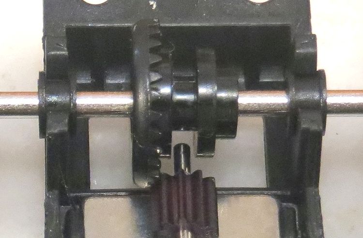

With the chassis out we can see the standard layout of the Sebring chassis, and again, with the hypothetic intention of putting this on the track we can look around to see what needs attention. The reason for the ‘gritty’ feel to the gears is two fold. Firstly, the centering slot in the contrate is for the standard 2.0 m.m. motor shaft, and the FF motor supplied has only got a 1.5 m.m. shaft. Not a big deal but most makers fit a fine sleeve over the end of the pinion shaft to space it out to the bigger size. On this model there is no sleeve and the axle and gear can slop noticeably from side to side, causing the pinion to go to the edge of mesh.
The motor is also offset downward more than one millimeter which moves the pinion further out of mesh! The fix? Well a pinion shaft sleeve for a start, and possibly changing the one piece moulded contrate for a Slot.it offset gear! And if I were going that far I would change the pinion too. This is a nylon ten tooth pinion which has full length tooth valleys. It is only a matter of time before the pinion will split along the weakest valley. A plus though is that the motor pinion shaft is splined! This should ensure there is no pinion slip as suffered by some other notable makes!
