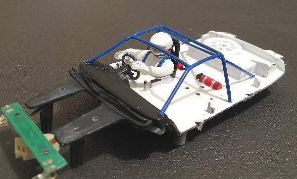

I decided to use an open faced half driver from Fly as this was the closest I was going to get for the time. The drivers were mounted on my painting sticks and day by day a fresh coat and a fresh colour were applied until I was happy with the finished article. I wasn’t game to try and duplicate all the helmet decals so I plumped for a straight white helmet with the Mobil One stripes. By now the drivers trays had been dismembered primed and painted. The extinguishers had a fresh coat of paint and the left side dash was blanked off and filled.
A new hole to house the instrument cluster and steering wheel was cut in the right hand side. A new dash peak was cut and mounted over the hole and both sides were puttied and rubbed back to a presentable finish. Later on the seat back and the finished driver were to be mounted onto the right hand side and the wheel and cluster were aligned with the drivers hands and glued into place with superglue. I mixed some super strength epoxy and liberally coated all the new pieces in place from behind. This was to give added strength to the superglue. The painted roll cage was reinstalled and this was to be it for the top of the drivers tray.

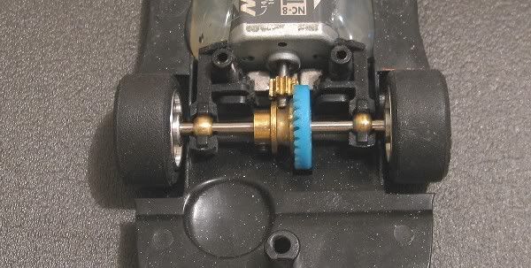

The working chassis had the pod glued into place. The conductor strips removed. A PCB guide mount glued into the spot where the SCX guide normally sits and the guide hard wired to the motor using silicone leads. A slot it contrate and a drill blank axle were incorporated and the motor pod was trimmed until the NC8 sat in its best spot.
The motor was superglued inside the now fixed pod and the assembly was hot glued to secure it and remove the risk of it working loose. I have a couple of models fixed like this and they tolerated the rigours of racing and you wouldn’t know the difference unless it was pointed out. It also save a lot of messing with brackets and screws and washers and with it avoids the ‘half Plafit’ look! All totally unnecessary.
Closing stages were the wheels. The test model was to stay with its original SCX spoked wheels and the remaining two would get some of Al Penfolds BWA masterpieces. These were with the BBS inserts as the true Brock wheels aren’t made in model form, but they’re hard to tell apart. The inserts sat too deeply in the wheels so plastic discs were made to space out the inserts in the hub. Once again these were superglued in place while the inserts were recovering from a good coat of spray chrome. Inserts were then applied and the whole outside of each wheel was given a coat of thinned clear to retain the aluminium shine. A word of warning here. There was nearly a potential disaster here when the wheels were tight on the extra large SCX axles. Tightening the wheel grub screw before final assembly caused a burr in the axle and at one stage I didn’t think I was going to get the wheels of again. The solution was to mount the SCX axles in a drill and spin them at high speed while sanding the area the wheels were to sit on. Only after I got a loose fit did I attempt to fit the wheels again. As expected, there was no problem with the drill blank axle.
