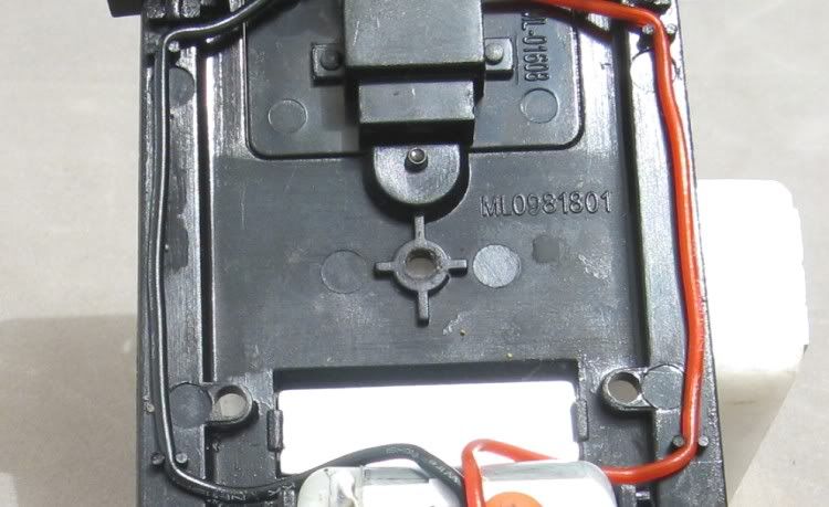

Moving onto the chassis, there isn’t too much to go wrong as this layout is tried and tested......or is it?? The light boards are very effective as expected and all the other model automotive parts are very familiar. Axle bushes are tight, guide OK, Motor tight, lead wires clipped to the chassis!! A good idea and maybe a Scaley first?? This does away with the need for another two pairs of hands while refitting the body like some Fly models do!
![Image](http://www.slotcarouthouse.com/photos/ScaleyRS200_leadwires.jpg)
One thing I did spot though is that the traction magnet is loose in its recess. Big deal? maybe not, but I was uncomfortable with it. So I placed a steel rule on the underside of the model to hold it firmly in place and put a couple of spots of Superglue on it to hold it in place. Hopefully I have negated the need to disassemble the model on a race night because the magnet has become detached in transit and is stuck to the engine or an axle or who knows what else!!

So, for the second time in its preciously short life the body was removed. The cause of consternation was immediately visible. For some unknown (or known) reason, one of the guide lead wires had burned through! Mmmmmmm! At this point I will explain to the novice that Scaleys arrangements for wiring at the guide end of the model are not every body’s cup of tea. In this case, one of the wires had failed unspectacularly and immobilised the model. The load on the motor caused by the jammed gearing must have been too much for what must have been a faulty wire?
![Image](http://www.slotcarouthouse.com/photos/ScaleyRS200_leadmelt.jpg)
The two single strands of wire which come from the guide to the DRP plug are in actual fact both legs of the little round ceramic capacitor!! The lead wires are attached to these legs quite high up and underneath the black shrink tubing. An ingenious idea from the design department, but in this case almost a fatal floor! So what needed to be done?. The guide was removed and the two contact plates were unsoldered from the guide loom.
![Image](http://www.slotcarouthouse.com/photos/ScaleyRS200_guidewires.jpg)
The single strands were unsoldered from the DRP loom which left the motor lead wires, one green and one yellow. The ends of these leads were prepared and lightly tinned and, while holding the little plates in a small alligator clip, I applied some heat to the terminal end and slipped the green and yellow wires into their new home, (see photo) thus bypassing the necessity to have the capacitor thingy or its frail legs. The whole lot was reassembled back in the front of the model and Robert ‘s your mum’s brother!
