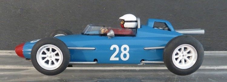

The model I chose to build has broken my first golden rule; which is, pick a model to suit the event, i.e. a low down model with low C of G, wide track and a short tail and wide tires. The body I have chosen is a sixties Lola MK4 as made by the Lindberg company, and where as it is moderately accurate scale, it was designed to take a clunky open framed motor and therefore is a bit bulbous about the midriff but no matter, I have specialized in the past in getting pigs to fly and I’m sure this one will present no greater challenge
First up was to decide what features it would encompass, My trademark circuit board chassis was always the first option and it would be powered by a 16,000 rpm slimline FF type motor. Gear ratio was to be 3.0:1 and wheels and tyres would be off the shelf from Pendle’s. Slot.It supplied the pinion and contrate and the axles where made from 3/32 music (piano) wire from the local hobby store.

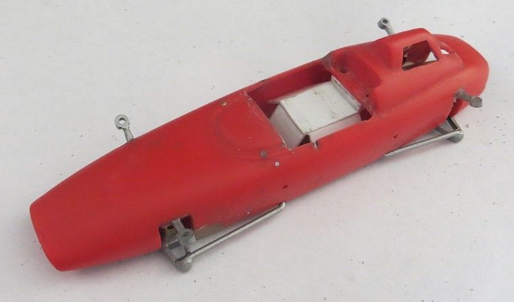

The body is next for some preliminary ground work. The chassis will be tailored to the body but firstly the body needs to be cleaned and tidied in anticipation of the chassis. The Lola is an old scrapyard item from a friend’s eBay lot so it came complete with daggie paintwork and various nicks and dents, plus there were areas where missing body panels needed to be created.
Once tidied up the missing bits were cast direct on to the body. This body shell had a section of rear skirt missing on the off side, and there were cut outs where what looks to be a steering unit must have fitted. I was running a solid front axle (this time) so, the non scale cut outs on the front axle recess needed filling.
A couple of thin squares of polystyrene card were cut to shape and superglued to the inside of the body these projected across the missing body area. Some extra strength epoxy was mixed and applied to the area. After about twenty four hours the card was pulled off and the epoxy was left another twenty four hours before the filled areas were sanded back into shape. A second application was needed to fill a couple of low spots and likewise would be rubbed back. Once complete, attention was switched to the chassis.

Next up was the suspension detail. I decided to replicate all the tie rods and not just some of them, this was easy enough and the remit here was to make them easy to fit. In the eventuality of the body needing removing it is essential that there is no necessity to remove other detail before this can be done, so the top rods will be attached to the body and the lower rods to the chassis and these will separate easily when the body needs to come off and also hopefully won’t get in the way if work needs to be done to the interior for any reason.
The material for these is 1.0 m.m. music wire, this is cleaned firstly as it will be easier while it is a straight rod than a bent one. The rod positions were calculated from scale drawings off the net and bent to shape. The short ends will fit into the wishbone detail and the longer ends will spot solder onto the top of the chassis.
Once in place the soldered areas were tidied up with a file and a sanding board. I fitted one rod at a time and after each rod I positioned the body over the chassis. Where the body touched the rod I marked its position on the body side. Using a round file I then filed a recess in the body side until the body fitted snuggly over the chassis again, I repeated this for the remaining rods, one at a time.
The top was a little harder; brackets had to be made to resemble the top control arms and once made, fitted to the body. The arm would also need to be angled up so that it cleared the collar on the inside of the wheel. After some careful filing, enough space was gained over the top of the front axle mounts and the arms were epoxied into place. The rear presented a similar problem but using similar techniques, the rear control arms were fitted snuggly in the rear, again, over the rear axle mounts.
Once cured (two to three days), the upper tie rods were made and fitted to the body. The rear ends were fitted to the control arms and again working from the drawing, the long ends of the rods were mounted through the body detail and secured on the inside, but I am getting ahead of myself here; This was all done after the body was painted to prevent paint getting on other paint and to stop the risk of damaging the finished job before it was finished.
Where the rods fit into the control arms I carefully soldered the rods in place leaving an excess of solder in place. I then applied superglue on the point of a modeler’s knife to the underside of the joints, this filled up any airgaps in the joint and helped hold the arms in place. Once dry they were sanded smooth. These parts are not specifically under any kind of stress while the model is running, and the only risk is that a wayward slotcar ‘T’ boning the model may cause some damage. But time will tell and I am fairly happy with their fixing to the model.

Last but not least is the paint job, I’m sure we all have our own methods of painting and this model will get its share of colour and clear. Decals are from my existing stock of numbers but for those without I’m sure Patto’s place will have more than you will ever want. Another ‘last job’ is the grille in the nosecone. I tried various textured plastics and effects but in the end I went for a simple fix. I stretched some cotton fabric over the neck of a jar and gave it a couple of coats of clear lacquer which I let dry hard. Once cured, I gave it a couple of coats of flat black. I cut a blank oval the size of the opening out of plastic, I then glued the plastic to the back side of the cloth, and when dry, lightly rubbed off the ‘fuzzy ‘ bits and eventually cut the oval out of the cloth, and another ‘voila!’ too easy!
The model was track tested in basic bare chassis / body form before it was painted and detailed so I am already pretty much aware how it will go. The tyres have been trued and seem to hook up well on my local track (flat painted board), but I suspect MJK’s will become the tyre of choice for regular racing. Wheels, tyres and inserts were from Pendle Slot and suit the model. Braids are medium soft and should be suitable for most tracks. Although it is a Ninco racing guide, the guide depth has been increased by squeezing it in a vice to improve its stability on routed braid tracks.
