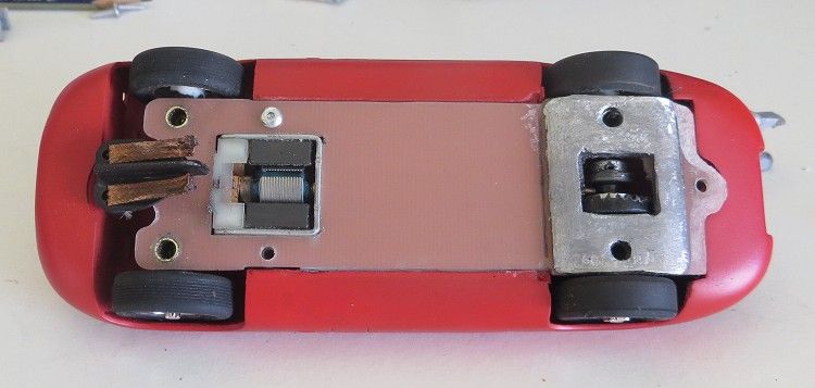

First to go into the body are the body posts, these will determine where the chassis sits in the body, and this has to be established before you can fit the axles and set the ride height! I have flush mounted the chassis to the body underside so now the tubular wheel and axle mount positions can be set. At this stage there is a big gap in the underbody where the floor has been cut out, but a new floor will be created and some material will be trimmed off the seat bases and other parts to compensate for the thickness of the chassis.
Chassis located in recessed underside…the ballast looks heavier than it actually is

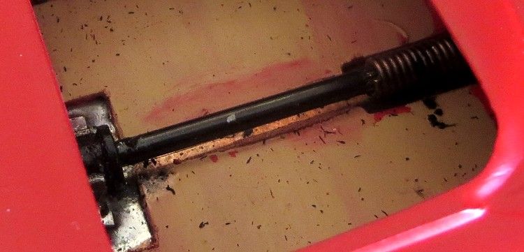

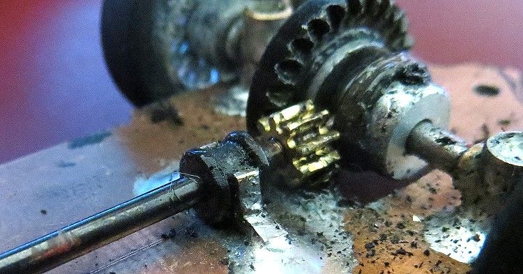

With the axles in place, the drive shaft and motor can be mounted. The motor is mounted midway between the cockpit and the front wheel arches. The motor output shaft was sleeved with some fine brass tube and this in turn took the drive spring at the front of the shaft. A ‘C’ shaped shaft bearing bracket was made from 3.0 m.m. brass and soldered centrally in place on the chassis in front of the rear axle taking care for it not to stick out too far into the cockpit area. The crown gear is a 27z offset gear. The offset allows the model to sit a bit lower than it would otherwise do.
Drive shaft in the cockpit
The cockpit/body needed a false floor as the old one was removed to facilitate the chassis. This is required to support the seats and the transmission tunnel. Some thin polystyrene sheet was cut to size and glue mounted in the body. After it had cured for a couple of days it was slit along the centre, removing a strip approximately 3.0 m.m. wide. This allows the drive shaft to pop in and out when the chassis is removed. Always let polystyrene cure for a couple of days after gluing. It will remain soft for this period and excessive handling will see the glued parts become detached.
Transmission tunnel in place over the shaft

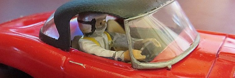

The driver had been test fitted some days earlier and was considered a good fit after extensive scraping of his posterior and the seat cushion. One thing I did cheat at was to fix the painted steering wheel to the driver and not the dash! Mounting the wheel in the dash and then getting the drivers legs under it was not going to happen, so, as on a coupe of previous models, the wheel was glued into the drivers grasp and the whole when dry was offered into the cockpit. Some superstrength epoxy then fixed the driver into his seat. Overkill with the glue? not really; I don’t need the driver coming loose somewhere down the road after the soft top is on!

Soft top clearance is important too. We don’t need to fit the top only to find the driver is too tall and the top won’t go on (it has happened)! This will be the last opportunity to get the driver posing well in the cockpit. Try to avoid a plain driver in a plain pose with a blank face staring into the distance. I tend to have them looking away from straight ahead and not at the sun visors! Some careful sawing part way through shoulder and leg joints and some careful reglueing will give a far more natural look to the driver!

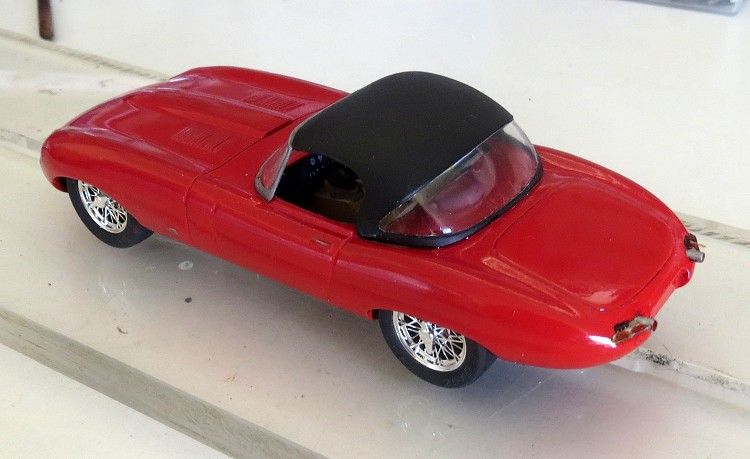

Again once cured the soft top can go on. This was masked before painting and the rear window was trimmed out of the masked area to make sure it was not messy by freehand brush painting. The edge of the masked area was given a thin coat of clear to seal under the edge of the tape. Once masked, the top was spray painted with Tamiya flat black. Yet again, each process was left at least overnight to ensure they would not pick up any handling marks from being too impatient.
Roof on! Phew!

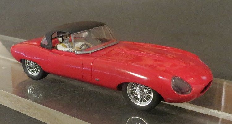

Last job is the road test. If you have worked to the closest tolerances on the chassis you will find the need to perhaps make slight adjustment to get the model to roll freely. A tyre may rub under a wheel well in which case either the tyre or the well may need some material removing. The guide may need sanding to smoothen operation or to get the nose down a little. And, especially after painting, there may be the necessity to remove some paint which has worked its way into the chassis recess. Whatever the reason, the job won’t be over until those crucial early laps have been carried out satisfactorily.
Completed model.
The model before ballasting weighed in at about 60 grams. I chose the little HO motor as it had plenty of revs (23,000 rpm @ 12v tested) and was not too heavy (11 grams) for the front of the model; it also gave it an NC1 type performance. Scalextric HO motors are readily available at a good price from eBay. On the track it is essential that the rear wheels and tyres don’t have too much work to do pushing the front along. The Ninco tyres have heaps of grip which seems to last years. I have models with ten year old Ninco classic tyres which, after a light sanding, still have close to their original grip! Final weight after ballasting was 70.0 grams. Weight was calculated so that the rear of the model is slightly heavier than the front (53% / 47%) to improve cornering.

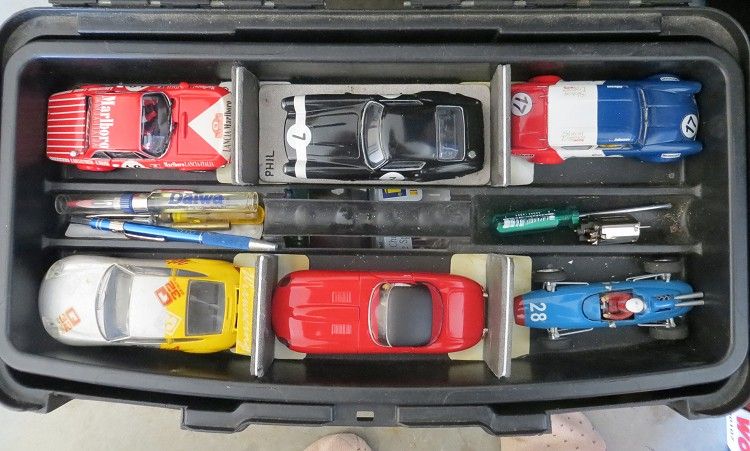

Initially I thought the model was a little too slim and short, but sitting it along side some stable mates it shows there is not a lot in it! The model was not conceived and built as a competition car, It is another of those exercises in model building and more to the point, it sits in the top of my race box along with some other classic scratchbuilds which I can whip out on racedays and do a few hot laps before things get serious. HO motors have already been used with some success by Scalextric in their original Fiestas and some of their early trucks, so there is no doubt of their ability to entertain and after all, this hobby is not purely about speed (for some of us) but more about parity on the track so that the end result is left to the racer’s talent and not his wallet.
Spot the odd one out?

I already have a couple of HO powered classic sports cars so this model wasn't really a new venture, and the whole model rolls out very nicely to perform about the same as a good Scaley FJ model. The NINCO classic tyres hook up well and the only post assembly fettling needed was to reduce the front track marginally as the tyres were just touching the body under the front wheel arches. With this done the true performance can be appreciated.
About as fast as an NC1, the model does not accelerate hard but winds up fairly quickly to top speed and likewise, braking distance is longer than the average 'S' can. Worth the bother? I think so, would I do it again? I thinks so. Stay tuned!
